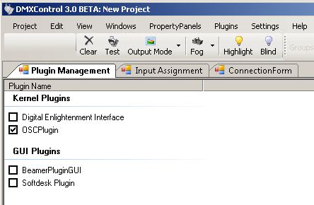

Both smartphone apps (clients) communicate via OSC with DMXControl 3. Therefore you have to enable the OSC plugin via "plugin manager", see following figure:
